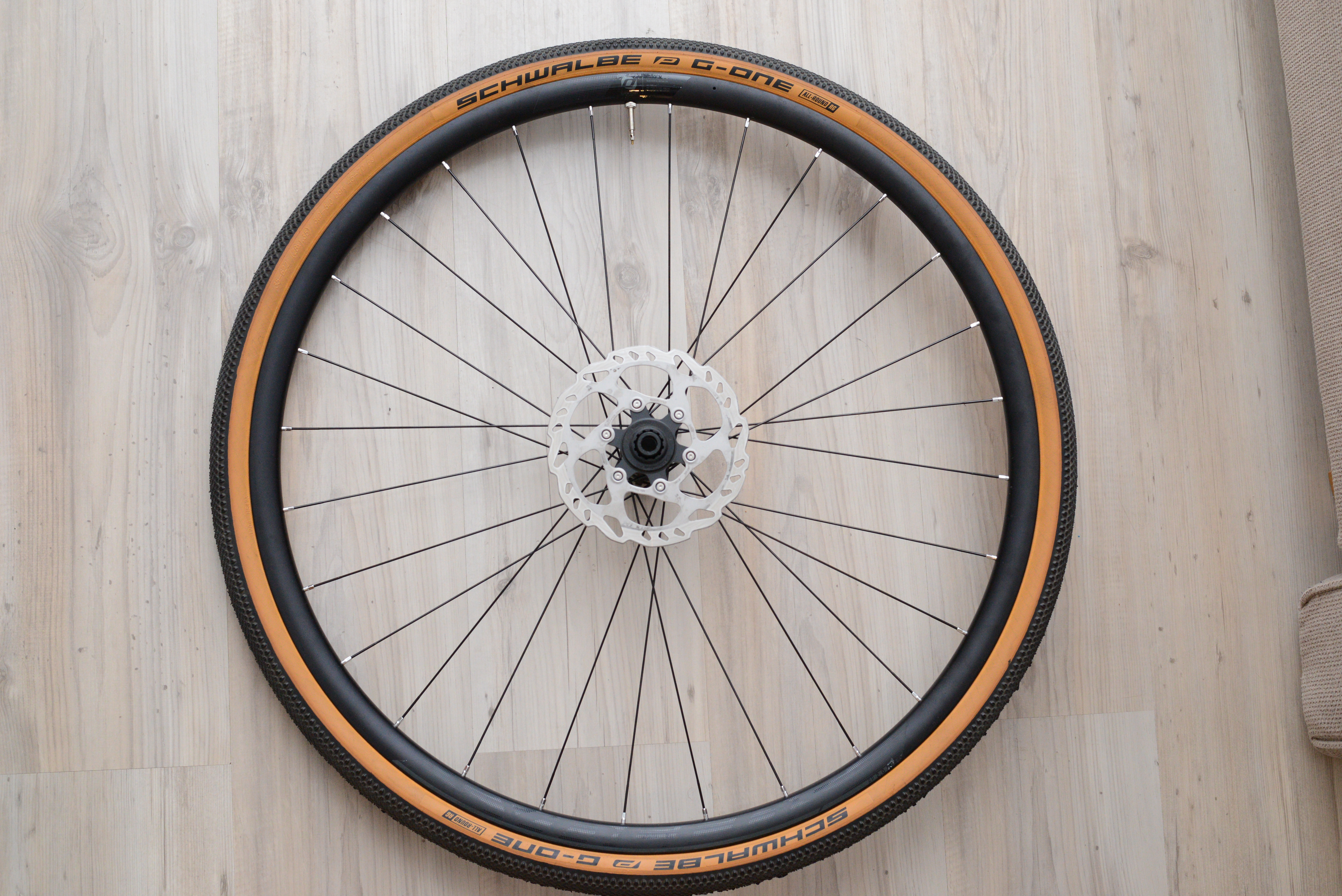

Schwalbe G-One All-round RG 622x35c ( Classic Sidewall ) rehvil TLE ja tubeless ready kirjad puuduvad. Kodukal TLE kirjas.
https://www.schwalbe.com/en/gravel-read ... e-allround
On ikka tubeless rehvid?
Eile, enne kui uurima hakkasin panin ventiili külge ja rugina sisse. Sõitnud ei ole aga 24h on pidanud.

RG - Race Guard (lisa Nylon kiht torgete kaitseks)
Tubeless ready? No!

Kodukal on kirjas, et on. Ju siis on.

Hello Alari,
Thank you for your message.
The tire in your picture is not tubeless compatible.
It is a OEM version which is not suitable for tubeless. If you run it tubeless, it might jump off the rim as it has another kind of bead core.
